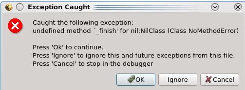

I tried a Linux compliled release and the windows one with the same result:
It works in the previous 0.25.8 release - is there a change required in the drc script?
report("DRC.rpt")
poly = input(1,0)
drc = poly.holes
drc.output("Holes detected")

Hi Andy,
I see ... unfortunate coincidence. The name "drc" clashes with a variable name used internally inside the DRC framework. This could even be useful, but in your case, assigning the drc variable with something breaks the internals. I wasn't aware of this side effect of Ruby's "instance_eval", but that's how it is.
Bottom line: please replace "drc" by something else for now. I guess "drc" should better be considered a reserved name. I'm sorry there isn't a better error message.

Hello Matthias,
thansk for the update - seems obvious. It works now.
The change was with the latest release, it worked before.
