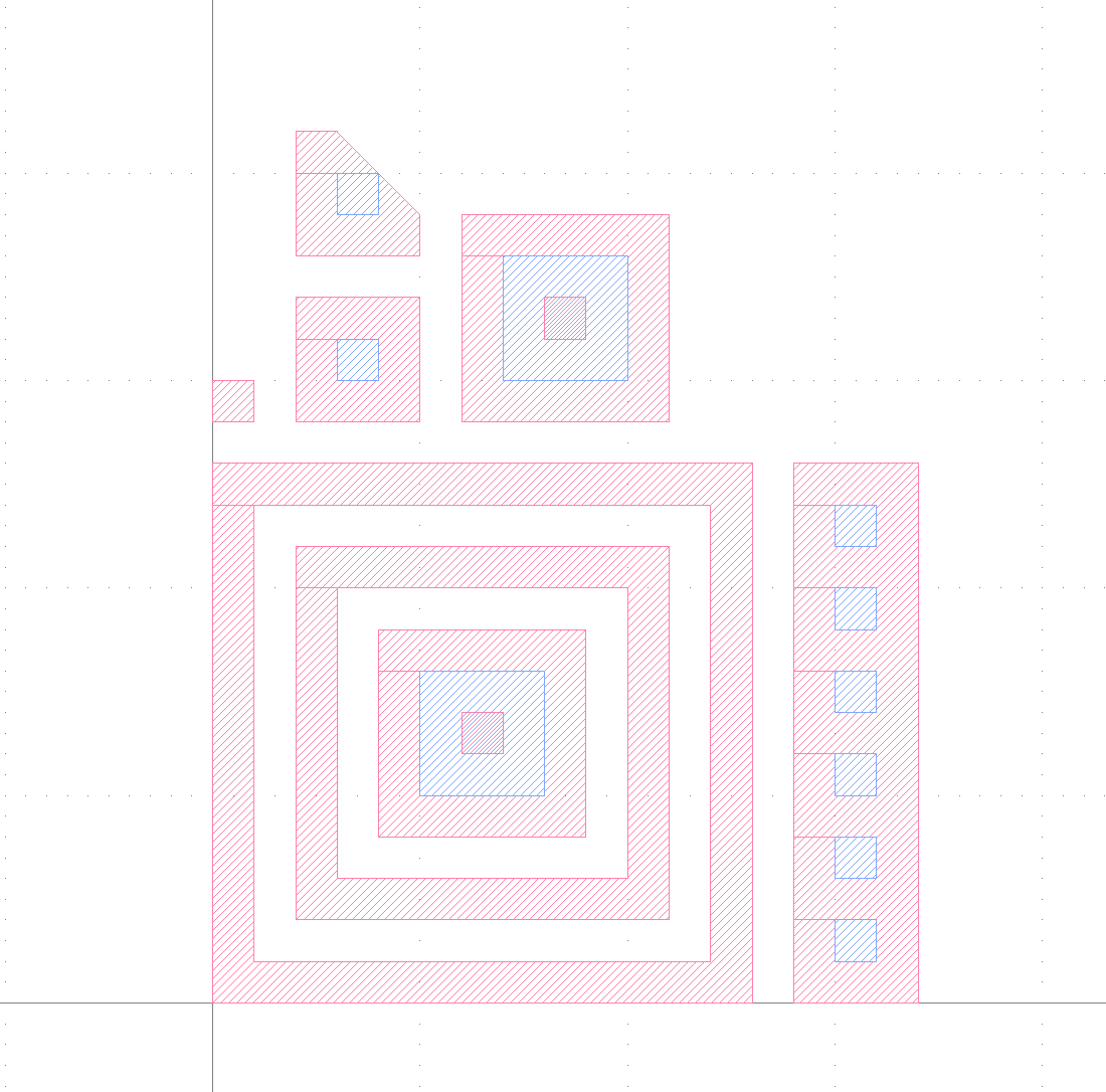

How can I reach the above result?
The "inner holes" are the holes that contain no any other hole inside.
My KLayout version is 25.0.5

But L2, L3, L4 cannot reach the result I want.
I think I need exclude the L1 with no holes.
So, I come up with L5, but why it fail?
Is there any short Boolean operation could find all inner holes?
Thanks!
@intervalrain That's an interesting challenge
There is no short boolean operation which does that. But I think this operation should do the job:
Thank you, Matthias.
In Version 0.25.5,
I could reach the result with
`L1 = input(1,0)
l1wh = L1.select{|polygon|polygon.holes==1}
l1wh.output(2,0)
inner_holes = (L1.holes-l1wh).select{|polygon|polygon.holes==0}
inner_holes.output(3,0)`
which is referring to your answer.
That's right. This is the equivalent code. But it's slower because the loop is going to be executed in the slow script interpreter.
