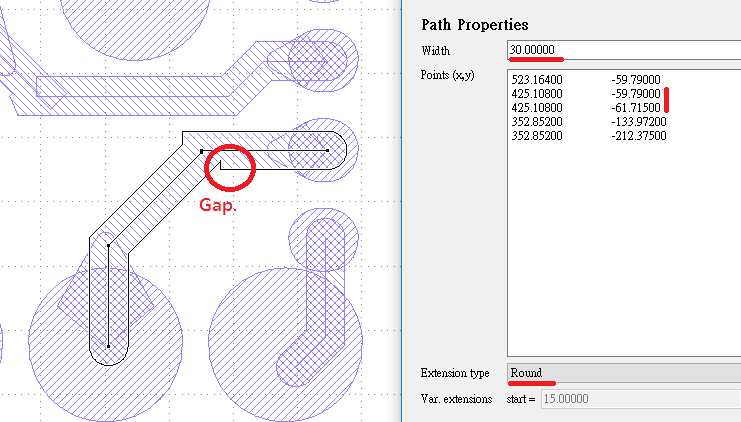

Hi sir ,

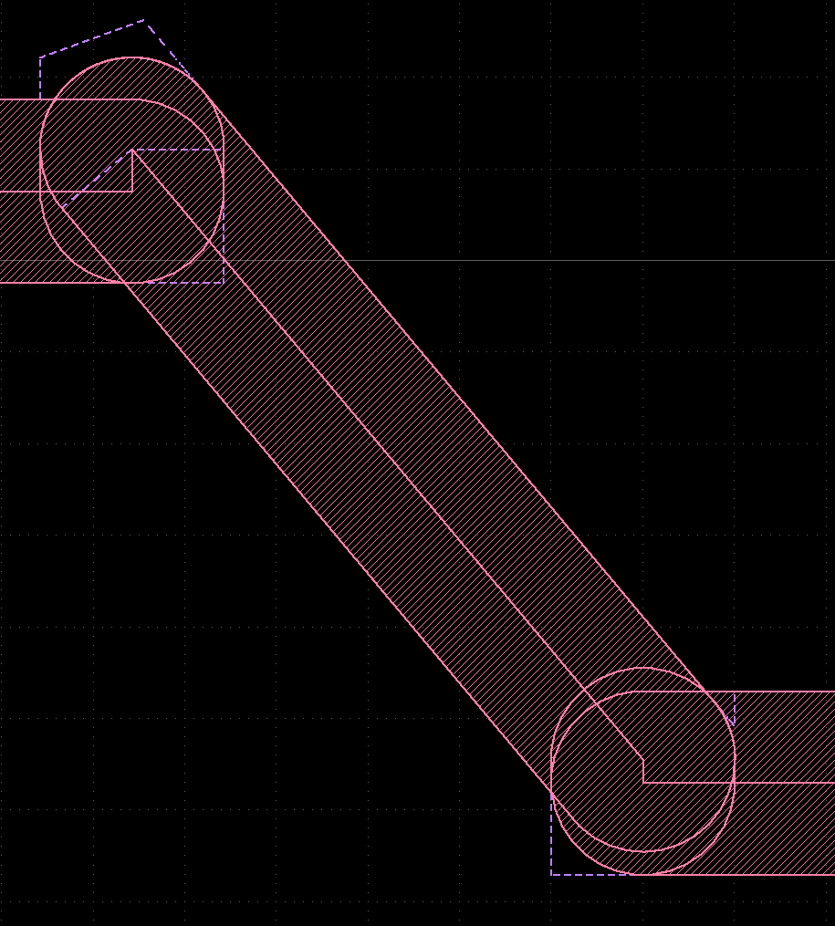

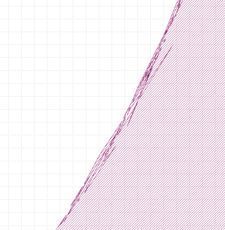

as Picture showning , I want to check /fix this path issue , that will make a gap in the area.
in the DRC function , can I check path points and width ?
(in the area , we have a lot of pattern , include shape and path , I need a function to filter path/shape in first.
The only way I fix these is by overlaying a "filler" or "cutter"
polygon and doing a merge or subtract as appropriate.
I imagine that Partial could drag the path straight too.
You have some other, uglier ones to fix around the round
pad at lower right and that needs something else.

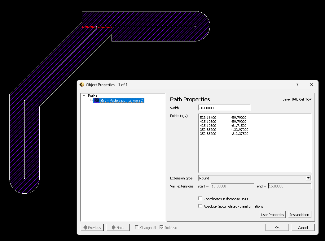

in my case , the design path been provided by customer and look like they using other design tool,
for draw / design the connect path.
it is reason our designer find that in some of our case.
when I check the path gap location , I find that may a solution to fix what the case I face to currently.
here is my code , I just remove the path segment when the length small than width /8.0
Actually, I have no idea for why that can fix trace/path broken issue , I just try and error base on
my coding capbility...

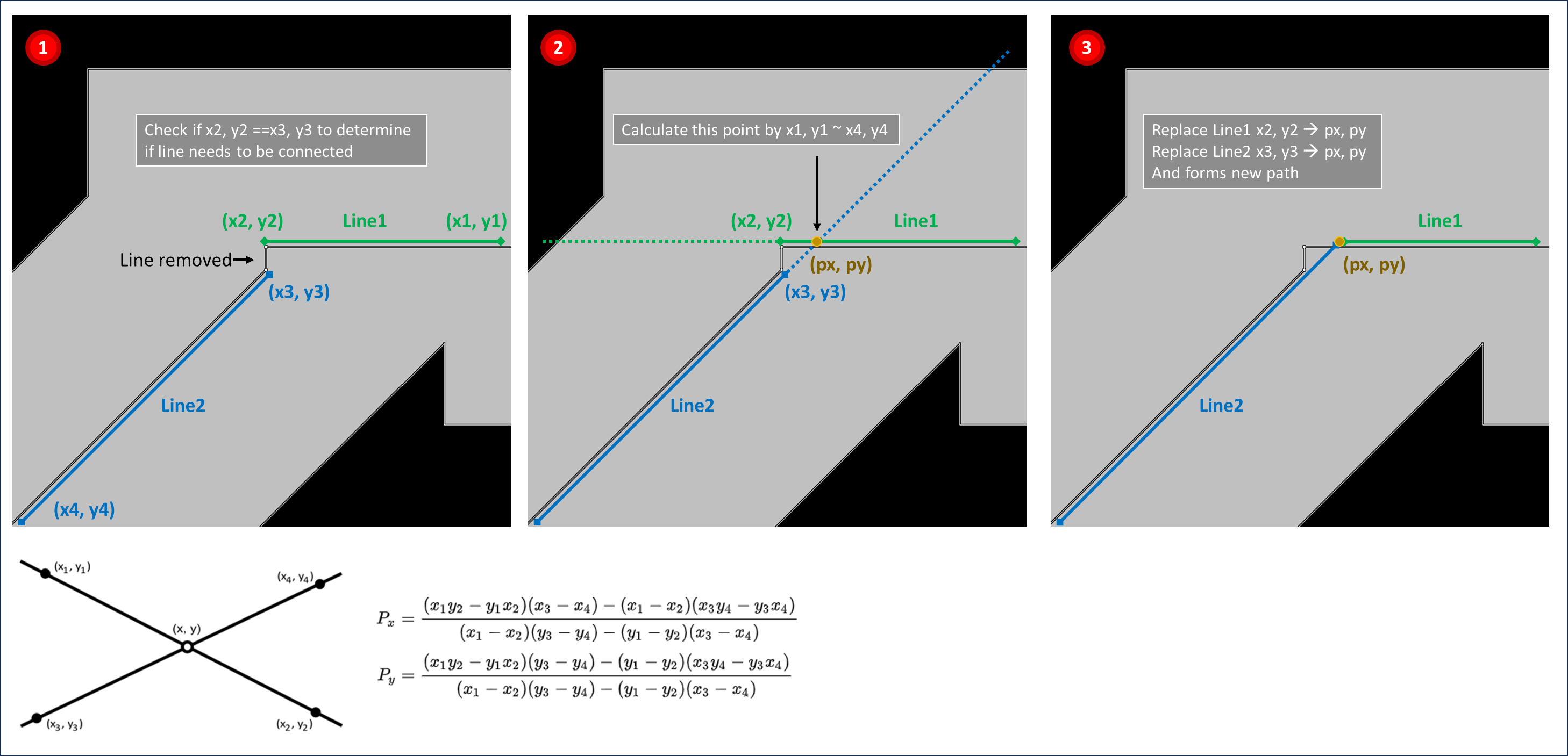

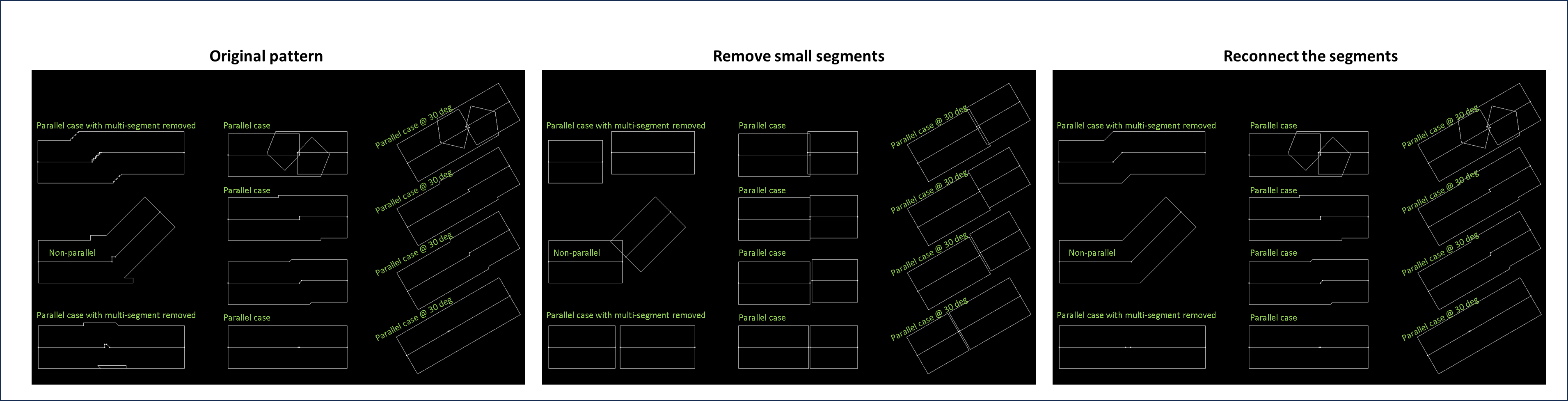

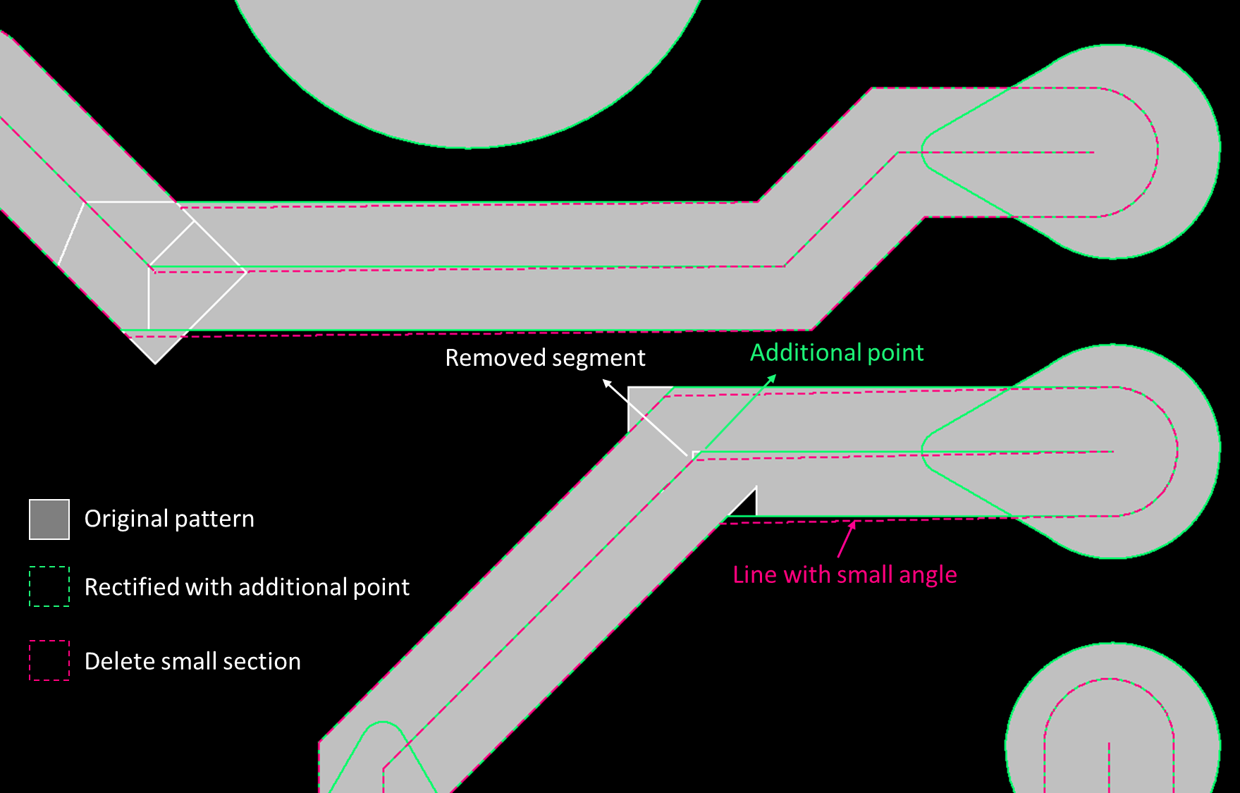

Hi jiunnweiyeh
It's me again, I've adapt your method and do some modification, the change I made is adding a new point at where small line segment is being removed.
the purpose of this it to keep all the lines at it original place and avoid having lines that is at a wierd angle.
the process for adding points, for the calculation please refer to this page
https://en.wikipedia.org/wiki/Line–line_intersection

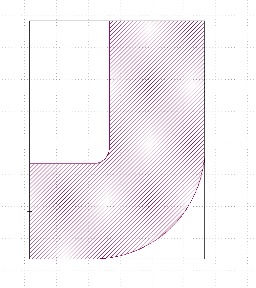

In general, the problem arises when path segments are shorter than the half-width of the path. This is a situation that should be avoided for well-formed paths (some foundries have respective design rules).

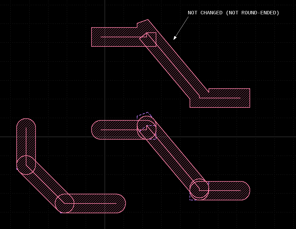

In your case with the round-ended paths, the usual way of fixing such issues is to resolve paths into sequences of round-ended segments, similar to what the circular aperture in Gerber does. Such a function is not readily available, but it can be scripted:
Here is the effect (red: after, blue: before):
the takeout shows how the resulting overlay paths become smooth:
In the PCB/Gerber world, the smooth edge transition following a circular contour is desired, while this is not the case in the VLSI world that KLayout stems from. In this world with Manhattan-style layouts, the corner-edge stitching mode is the commonly accepted behavior and round-ended paths are a legacy concept that usually is avoided.

Hi Rawr,
some of case in your code.. the "((x1 - x2) * (y3 - y4) - (y1 - y2) * (x3 - x4))" will be zero (0)
I still under try to find other solution
Hi jiunnweiyeh
the case that triggers this error is when we tried to find an intersection point of two parallel segments
I've modified the condition for connecting broken sections
if the line is not connected, check the slope and create an intersection point of is a non-parallel line orjust reconnect them if is parallel line

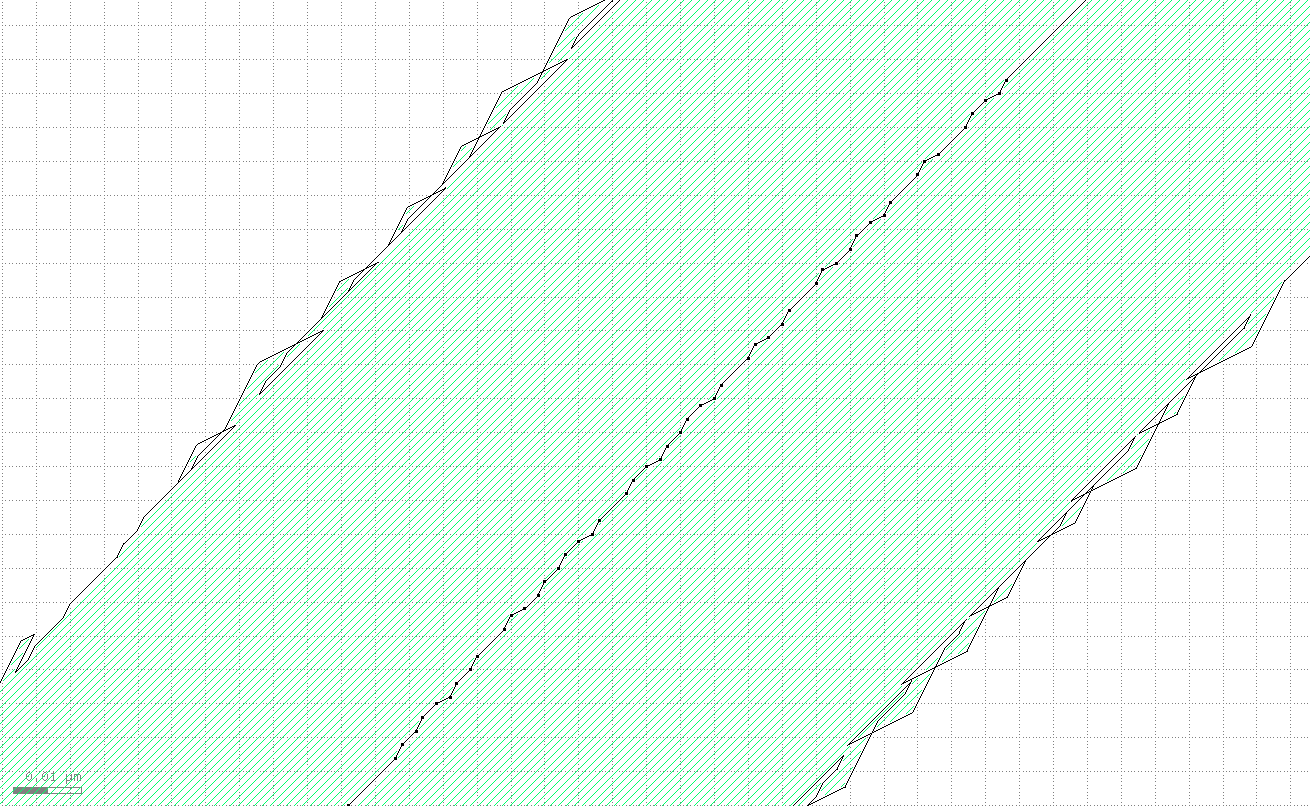

I am an student learning optoelectronic chip layout , Sometimes I have a problem which electrical chip won't have. For example
I write a function to generate Points ,then use Path.new([Points],width) to draw a waveguide .Here comes a question: A waveguide have a turn, and the turn radius is small, but the waveguide width is relatively big ,
then the Polygon drawn is not correct
As you can see, Its edge is a mess. I think it's the fault points order makes the mess. If I make the spacing between points larger , the mess disappered, But the accuracy will not be enough.
This problem has been bothering me all along, Anyone have a good idea to solve this?

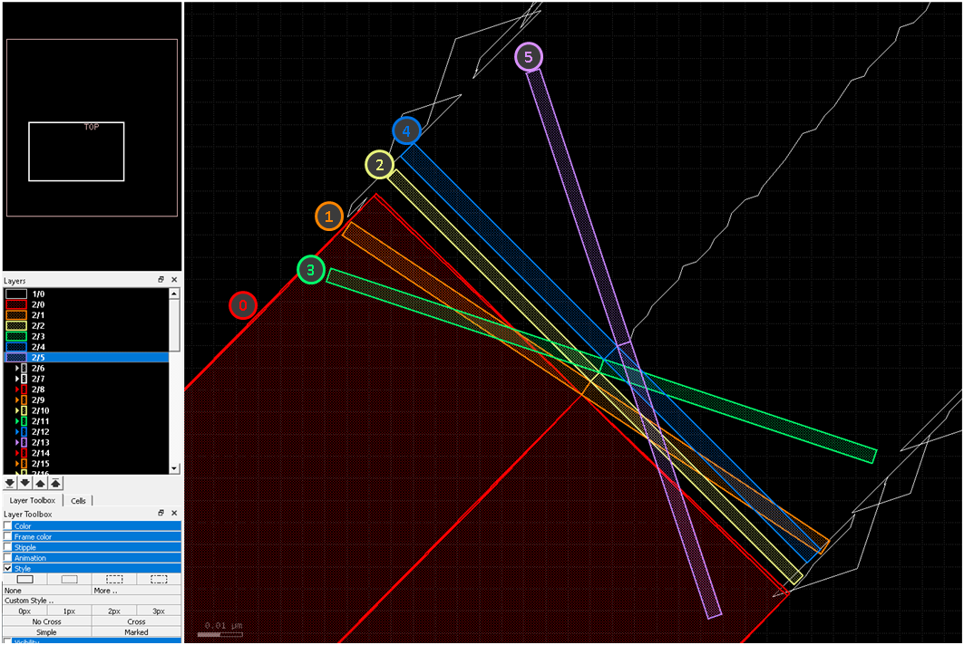

Hi Default
if you check the path segment by segment like the image show below, you'll observe colsely you'll see that the path is actually doing a quite sharp turn and causing the edge portion swinging back and forth and results in a broken edge contour
follow (0) red --> (1) orange --> (2) yellow --> (3) green --> ...
To elimitate this the segment length needs to be increased and the angle of each turn needs to be reduced.
and to have a more accurate control of each turn angle, you might need to adjust to a even finer grid size.
another way is to adopt Matthias approach and replace path into a round edge segments.

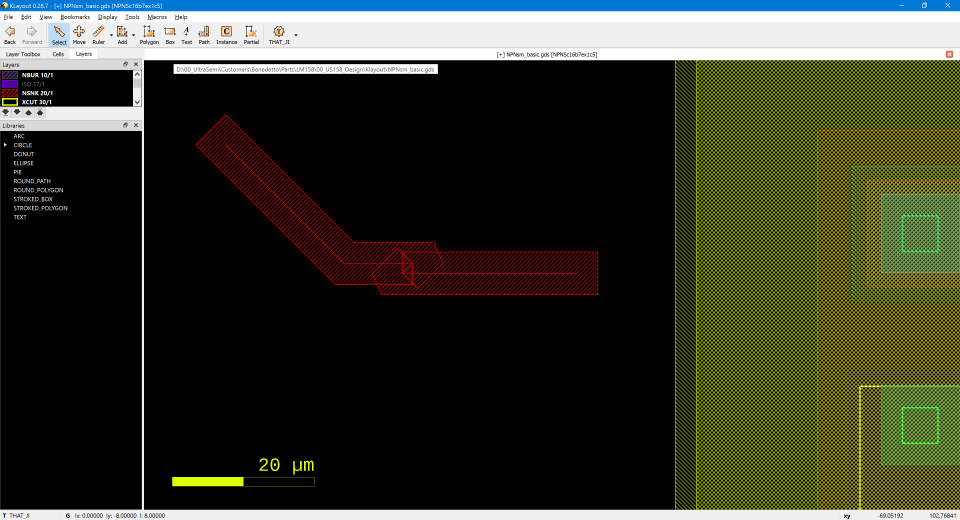

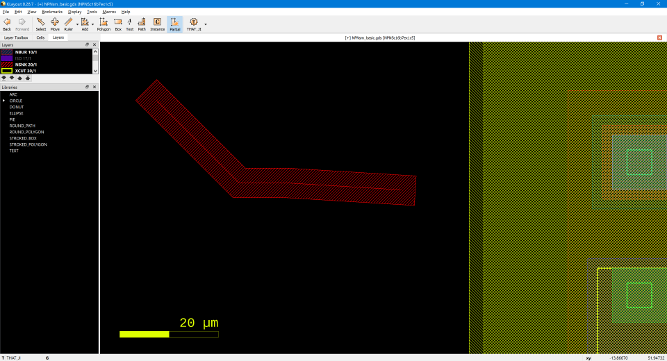

Just a thought, but to me looks like there are too many vertices
and some make for kooky path generation.
Is it practical to use Partial to select one "don't need" vertex and
delete it? This seems to work for me, deleting a vertex leaves the
rest and the path regenerates with one less segment.
Messy path:
Partial select one vertex:
After Delete, one less vertex, still a path:
I imagine this could be somehow scriptable, to find (say) a vertex
which lies between two segments which have "abnormal" angles
(like, I would never make a <90 angle ever - I do 90 and "45s"
which are really 135 degree, acute angles will always make a
DRC space / notch error that has to be papered over in the sub-rule
gap region.
