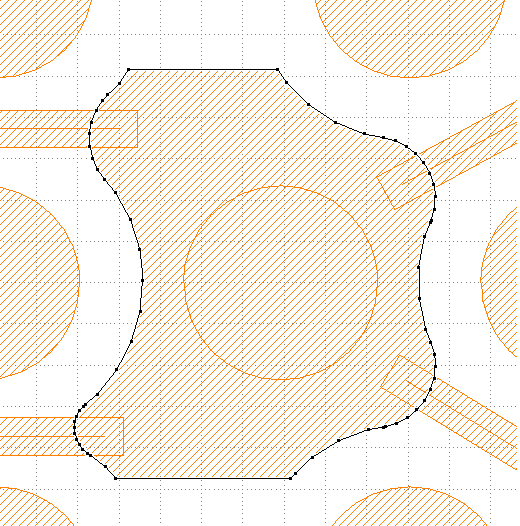

You can use Partial mode to select and then Delete a
vertex or vertices, and/or move around the ones that
remain.
The vertices are not positioned by some global setting,
they are hand placed (or converted from some other
tool's hand placement I suspect) so probably the
solution is manual as well (no "master key").
remain.
Thanks for the hints. Any possibility to make simplification process automatic.
It seems there is a package called "Symplify" fits this function well, but when I clicked into it, it said "Pahe not found". Any one knows how to get his package working.
https://github.com/fsitok/klayout-simplify.git/tags/0.0/doc/readme.html
Sorry, I figured out the operation is straightforward as long as the package is installed through "Manage Package". Sorry for my interruption.
