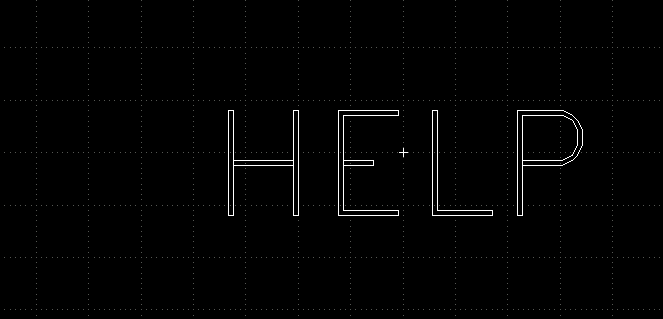

Hi Thomas,
looks like it's working at least for my version:
Most formats except GDS do not preserve text alignment as there no such feature there. Maybe you're looking at texts you have writted and read back?
Thank you for the fast reply. I upgraded to version 26.10 and the code works indeed fine there :-)
Must have been a small issue in version 25.8 as I'm aware of text alignment preservation in GDS only and did not write and read back.
