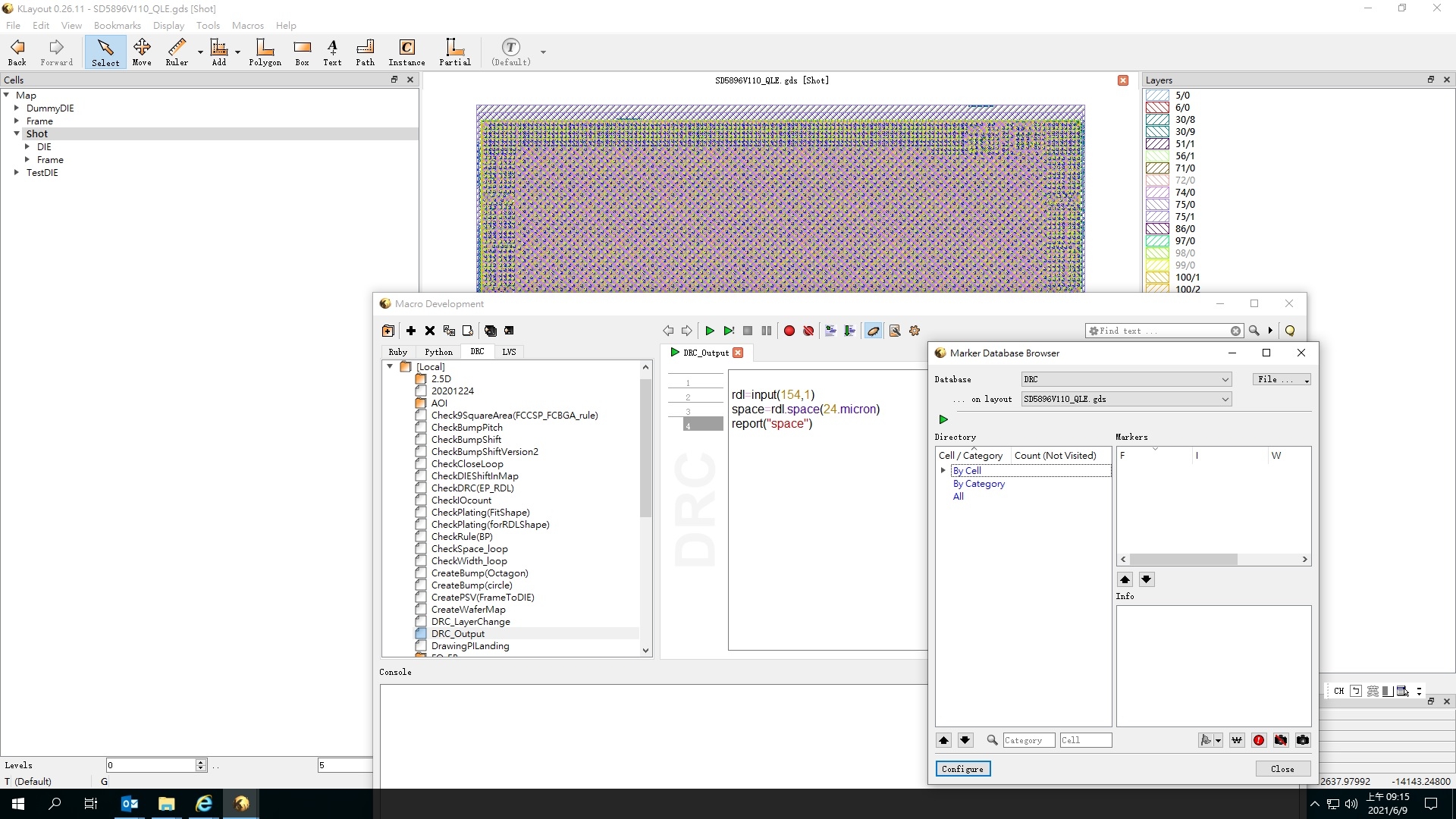

Hi Sir ,
I can do DRC as this code
rdl=input(154,1)
rdl.space(24.micron).output100,1)
But , this code will output a pattern layer to shown where the out-rule is ,
I want to call "Marker Database Browser" to shown all the out-rule location and coordinate.
here is my code , I knew I lose a code "source " , but I have no idea how to using that.
rdl=input(154,1)
space=rdl.space(24.micron)
report("space")
Just check out this link: https://klayout.de/doc-qt5/manual/drc_basic.html.
@jiunnweiyeh You should put "report" at the beginning. "report" will make all following output statements being sent to the marker browser.
