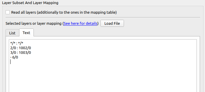

you can already do something like this:
This will read all layers, then specialize for layer 2/0 and 3/0 to map to 1002/0 and 1003/0 and finally unmap 6/0.
Note that "Read all layers" is turned OFF so that 6/0 is not counted as "other layer".
However, when you use this editor, it will turn this list into the logically equivalent, but garbled version:
