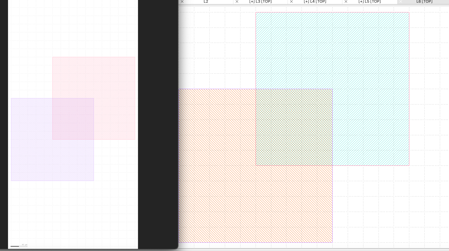

Hi @Vincent%20Lin
Thanks for your code, but there is another problem: The color of box is incorrect.
Do you know what the problem is ? thanks a lot.

No, that's simply the way the colors are specified. See my note about hexadecimal notation of color codes.
If you want the layer to take a specific color use the hex RGB triplet notation that HTML uses too (e.g.
#ffd700for "gold") and turn it into a hex integer constant (`0xffd700´ in that case). Also make sure you set fill and frame color to the same value if you want them to be the same. In the above example, only the fill color is set and "100100100" is not a meaningful RGB triplet.Matthias

the screenshot of code #1 is empty , then I run the code #2 ,It returned the same layout_view hash but the screenshot came back.
Wang
Try to insert "layout_view.update_content" before "get_image" or use "get_image_with_options".
"get_image" shares the view with the event-driven Window system and changes to the view may not be immediate.
