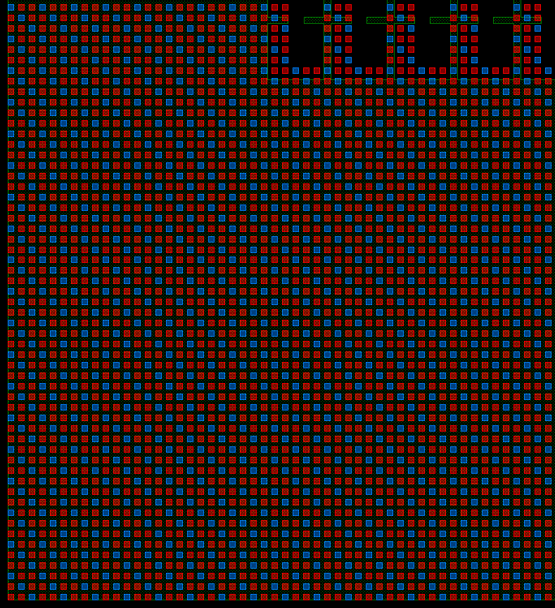

1) I would like to fill a layer called "layer_to_fill" (green in the screenshots below) with a tile "tile_M1" (blue in the screenshots below):
tile_M1 = fill_pattern("TILE_M1").shape(20170, 0, box(-0.244, -0.240, 0.244, 0.240))
layer_to_fill.fill(tile_M1)
This works great:

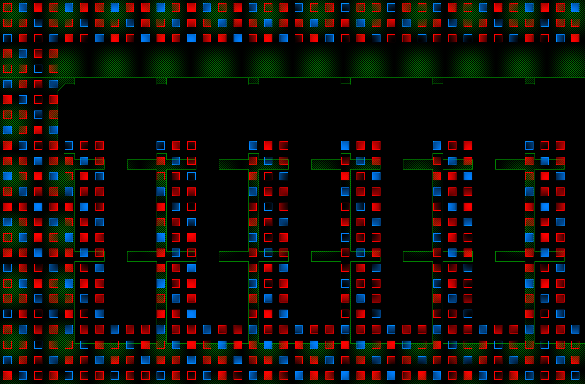

If I redo this with an offset, I see that the tiles are shifted as expected, but there are now also tiles going outside the "layer_to_fill" shapes (ellipse)...
I would not expect this to happen or am I missing something???
tile_M1.origin(-0.3, -0.3)

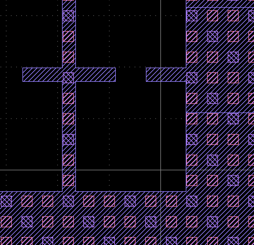

Here's another example (with attachment): I would like to fill layer 3/0 (green) with two different tiles T1 and T2 and one out of three needs to be T2 and the T2's need to be placed diagonally, like:
T2 T1 T1
T1 T2 T1
T1 T1 T2
One way is to create a bigger 3X3 tile with the scheme above, but this will leave too much of the fill area empty so I was thinking about doing 9 (individual) tiling iterations.

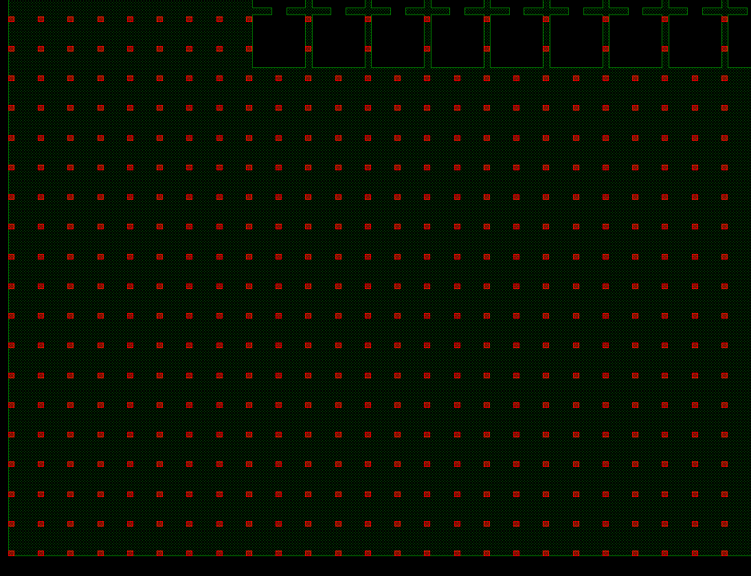

The first one works fine:
But the other iterations (using .origin) create tiles outside of the layer 3/0 shape(s):
Is this like a kind of bug? (If not,) is there another way do this?

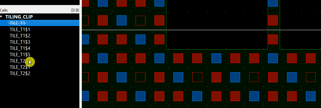

(For each iteration, a new cell is generated (TILE_T1$x, TILE_T2$x), hence my question to refer to an existing cell of the layout instead of using the fill_pattern method...)
Hi @tomas2004,
That's not a bug. "origin" for the fill pattern does something else than what you expected.
First of all, this is my version:
Which gives this:
"fill_pattern.origin", together with "fill_pattern.dim" specifies the pattern bounding box (the "drawn area"). You tried to shift the pattern which basically works, but it will also specify a bounding box that is not the drawn area. The drawn area is given by the shapes you add - like "box" etc. - and it will not change when you set "origin". The effect is a shift, but after that the "drawn" shapes sit outside the box, hence the do not sit inside the fill area.
The solution is to set an origin in the "fill" function: this will decide where to place the first instance of the pattern. I had to switch the sign of the coordinates, as the effect is a positive shift then.

For each iteration a new tile is generated, although TILE_T1 to TILE_T1$5 and TILE_T2 to TILE_T2$ are identical. This is not a problem, I can "clean up" with another script. It's actually useful to visualize each iteration individually.
Very good
The fill feature will generate new cells when you feed it with "fill_pattern" things. Technically, the "fill_pattern" is just a collection of shapes, but as the fill feature internally needs a cell, it will make a cell from it, not knowing that the fill pattern did not change between the calls.
To avoid this, you can put the following code in front of your DRC script:
This monkey-patches the DRC engine to skip creating a new fill cell, assuming that same name means same content.
