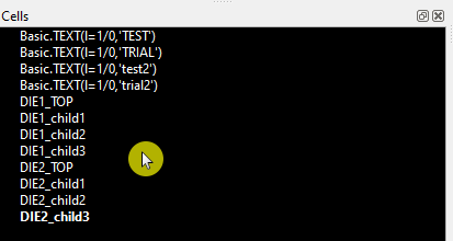

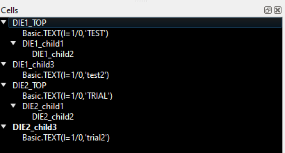

1) What I normally do before merging gds files is giving each one of them a unique prefix, like "DIE1_", "DIE2_", etc. using the rename all cells script (https://www.klayout.de/useful_scripts.html#rename_cells.lym). This way you will not have the issue of having identical cell names between the gds files and after the merging all the cells are not mixed up and it is much clearer to see which cells belong to which layout, especially in "flat cell list" mode.
Below, I merged 2 gds files which originally have the same cell names but I added the prefixes "DIE1_" and "DIE2_"
"flat cell list" mode:
2) I don't see the point of converting the text cells to static:
a) the text pcell does list the layer and text parameters between brackets as shown above
b) why not just copy and paste the text pcell instances and change the layer parameter of the copied instances?
c) If pcells need to be converted to static, I would do that in each gds file to be merged before adding the prefix, so that they get the prefix of the design they belong to.
