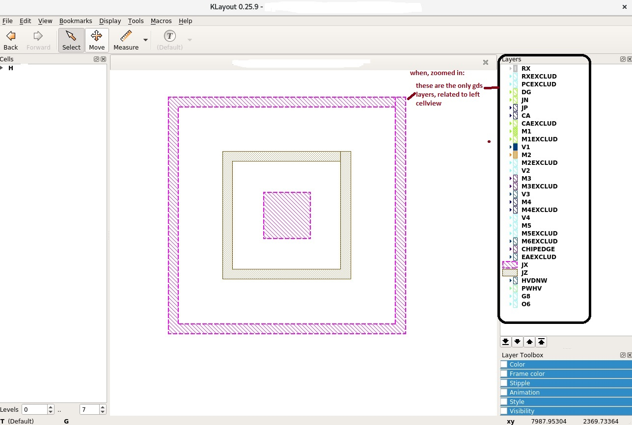

When I zoom in on a specific cell, I prefer seeing only the layers related to it. See attached pic "klayout_zoomed_in_view".
What is the required setting/setup for this?

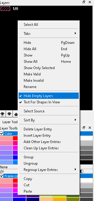

Hi ajantonio47
Right click on Layers and check both
Hide empty layers
andTest for shapes in view
options.This should do the trick.
