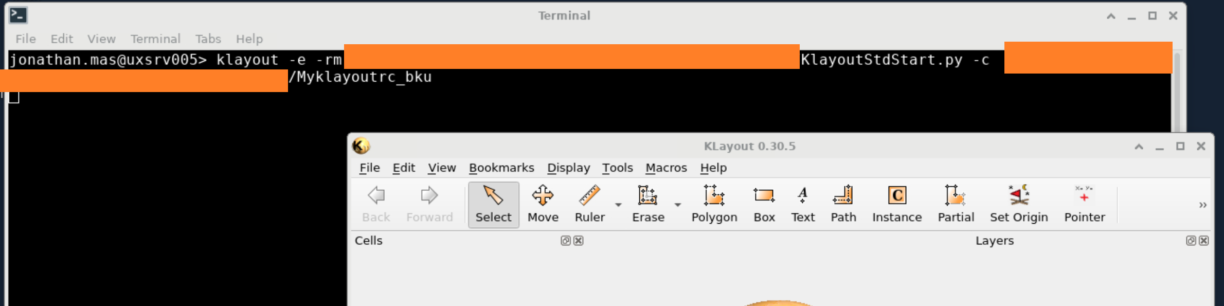

I had a similar issue, except that k-layout would not crash but no box/polygons would be created.
the issue was coming from the config file that was loading when starting k-layout (-c)
I made a new config file and it works.
Config files are a bit large to share, bellow is a AI generated file differences between both files.
I tried with to switch to see if it was the issue: it was not,
In my opinion, there is a good chance however that the origin of the issue is due to the fact that the config file was initially made for the viewer mode.

You had "erase" mode on. There is a warning when KLayout starts and you use erase mode. I guess you ignored that.
(bad mode if you expect polygons to be drawn instead of erased)
Great to know thanks!
Regarding the warning: I could not see any (see picture) do you know where I should go to find these warnings?
but I also notice that I now do not have the "ERROR: Signal number: 11" anymore too, so I am also a bit confused ... in the meanwhile I also asked IT to install latest version, so maybe there was an issue with the set-up...
