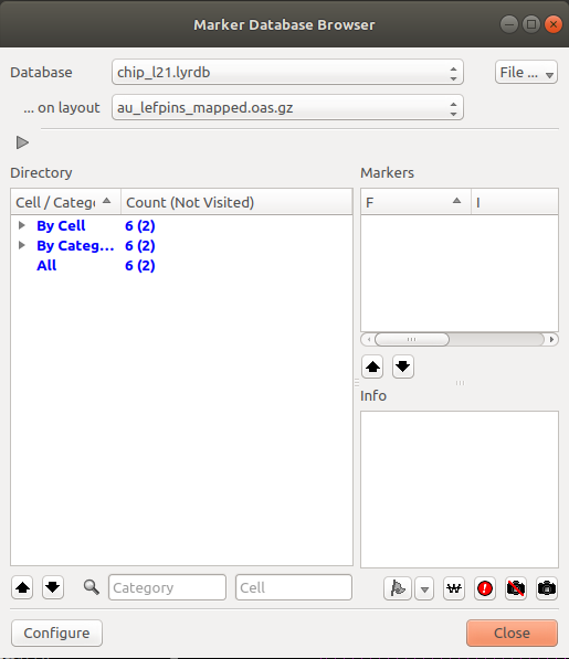

But after a several time the memory get full because all runs results are kept in memory.
Is there a way to purge the previous DRC run results from memory ?
BRgds,
Laurent
Comments
  • Hi Laurent,
    yes there is :)
    In the marker browser's "File" menu (top right button) chose "Unload all" to purge all results
    Best regards,
    Matthias
