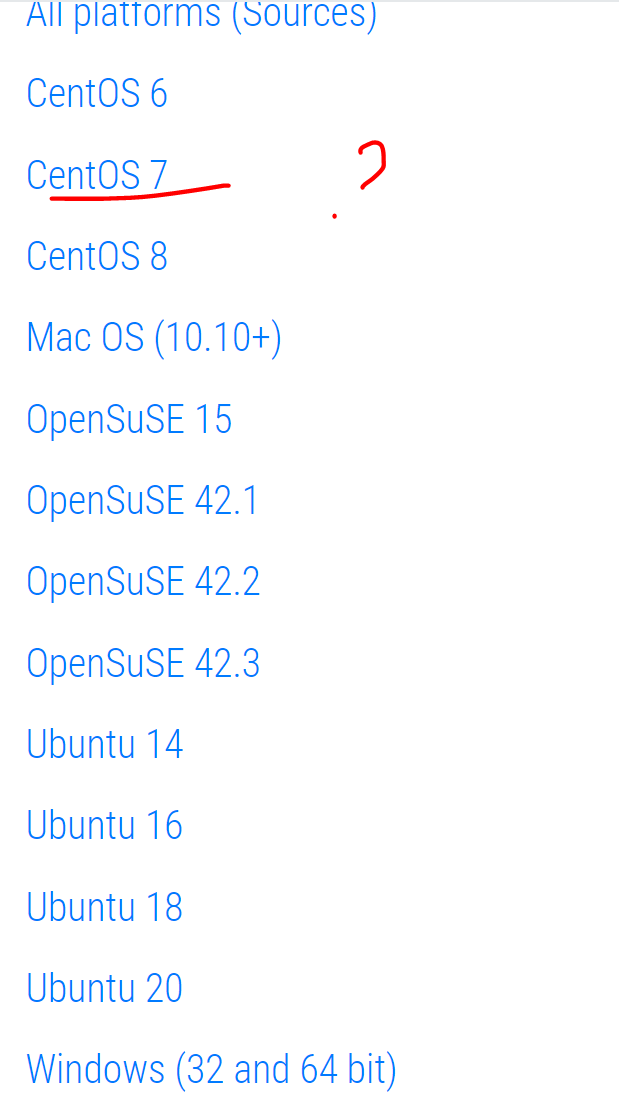

If installed, I want to install from the latest version.
My linux system is Red Hat Enterprise Linux Server release 7.6 (Maipo),whcih version of klayout package should I install? Centos 7?
