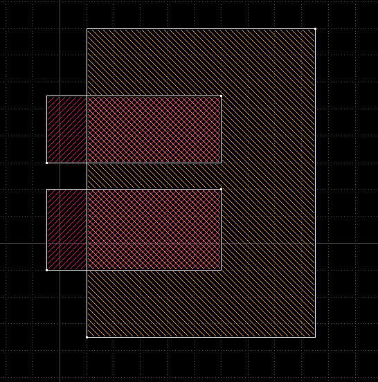

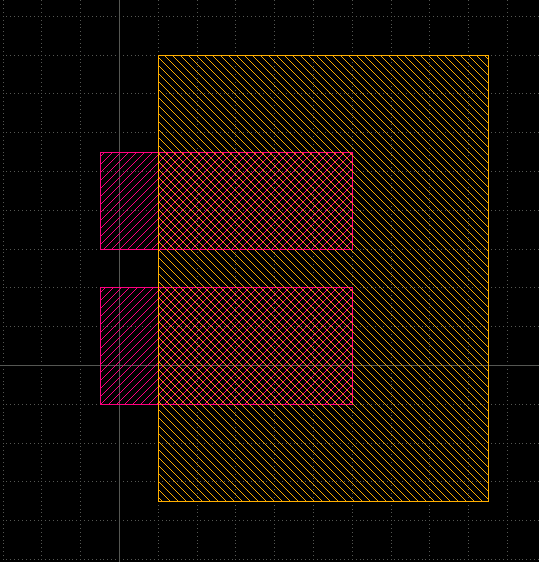

What I noticed today, is that
1) The "cutter" evidently does not have to be on the same layer
(I was trying to cut "TANK" with "TANK", but I had an identical
sized "Text" object instead; it got cut, all the same).
2) When used to cut something of a different layer, the "cutters"
do not get destroyed.
So, if you want to make multiple "stampings" without having to
redraw, or duplicate-then-move (a plain old regular copy-from-to
would be so handy...) you can use a "cutter" that's from some
unused layer and it'll stick around, to be reused.
