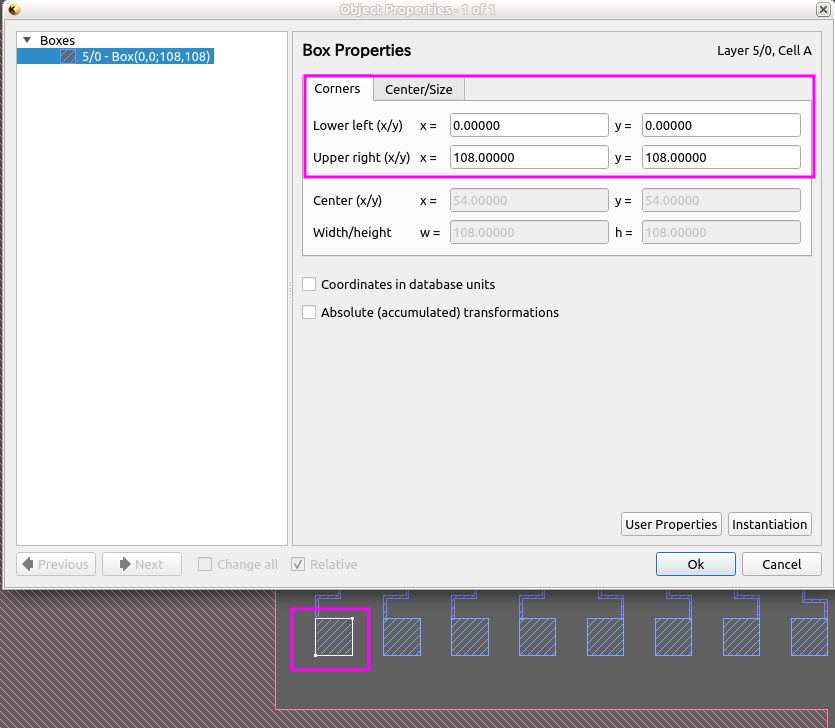

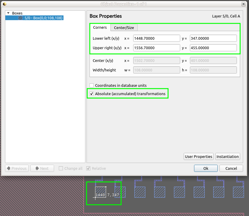

I'm wondering if there is any helper function/method that allows me to retrieve the absolute position of a shape (relative to the top level cell) in a hierarchical GDS - or do I need to walk my way back to the top cell through the instance tree ?
The use case is to retrieve the position of shapes on a particular layer that defines the bonding pad openings in a ASIC.

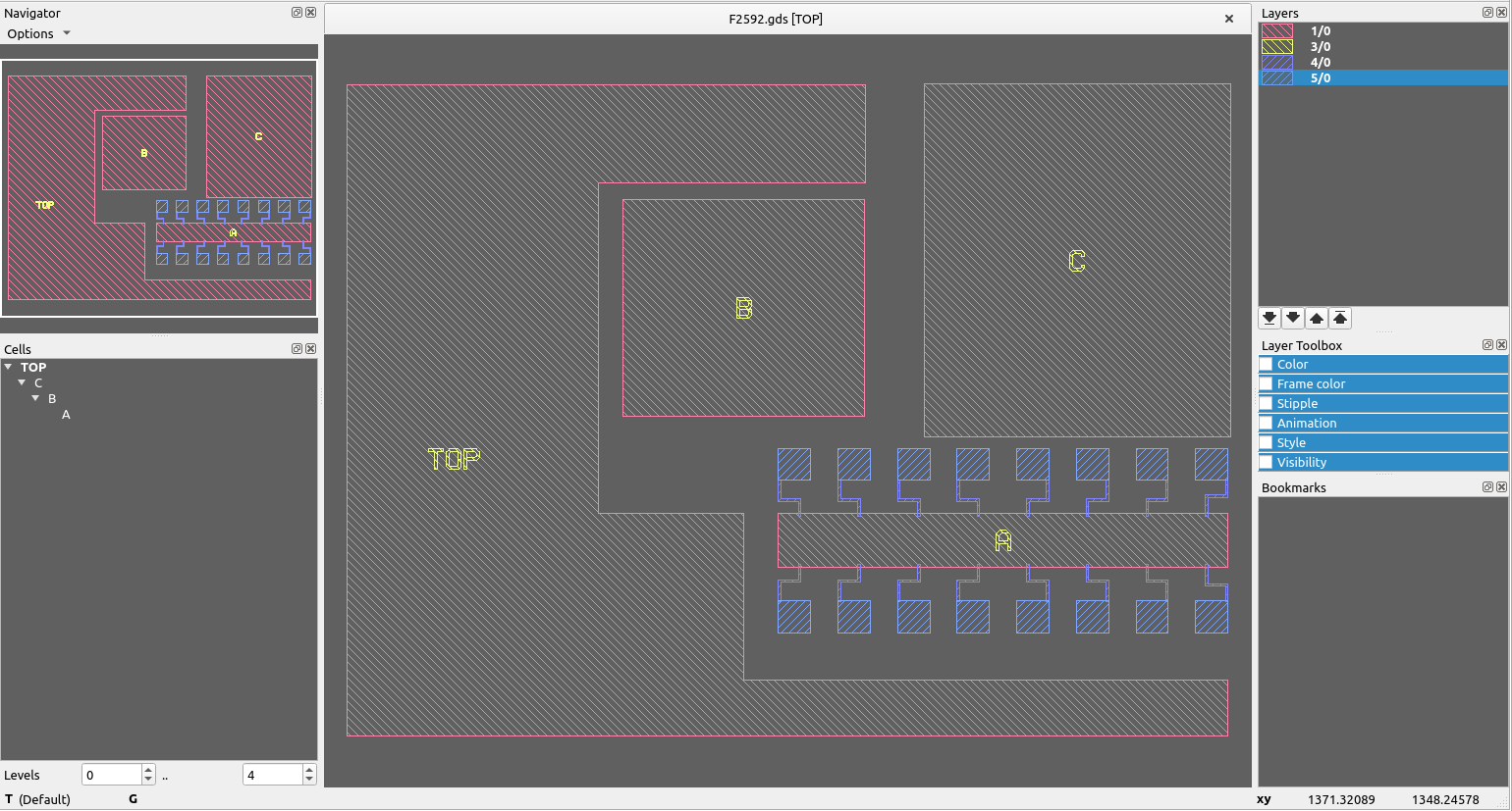

The shapes I'm collecting are "deep" into the hierarchy of the GDS (they don't belong to the top level).

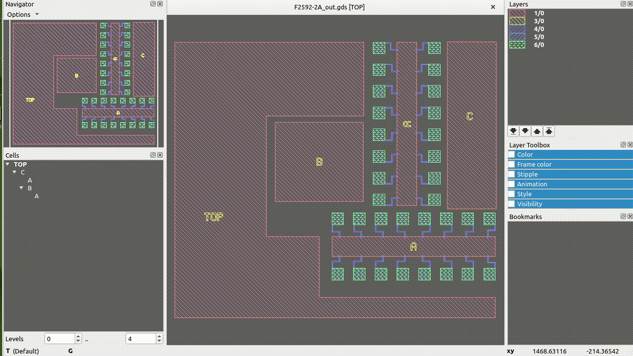

Test Data
Code and Results

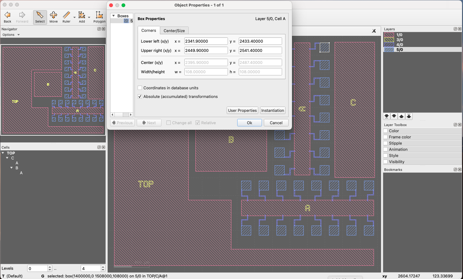

With two instances of cell
A
