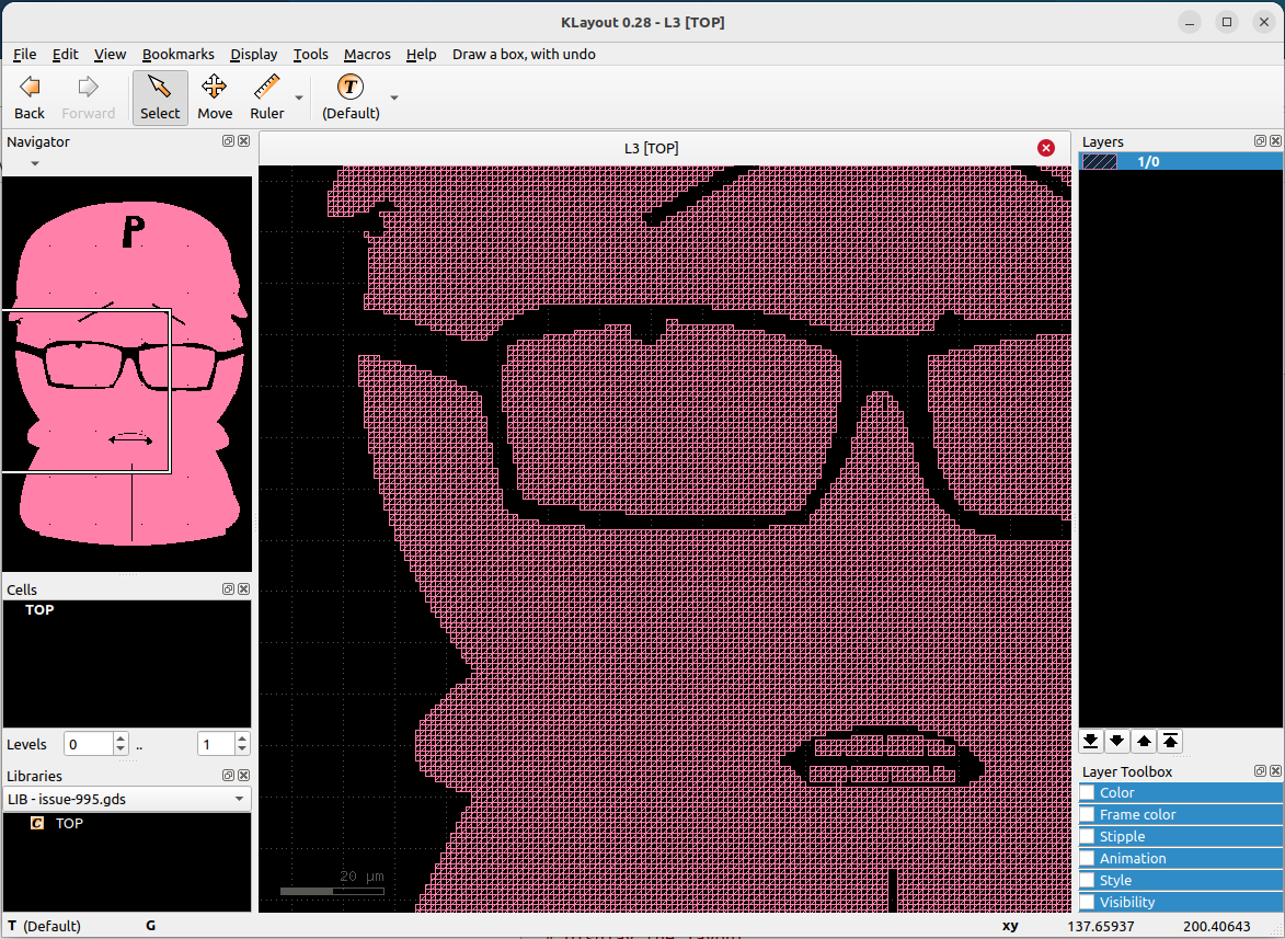

    But here is a small piece of code turning an image into a layout:
    # Prepare a layout
    ly = pya.Layout()
    l1 = ly.layer(1, 0)
    top = ly.create_cell("TOP")
    # Load the image and convert to RGB32 for easy decoding
    img = pya.QImage("/home/matthias/Pictures/avatar.png")
    img = img.convertToFormat(pya.QImage.Format_RGB32)
    p = 1.0  # pixel size in micron
    # Scan the image and create a box for each "bright" pixel
    for x in range(0, img.width()):
      for y in range(0, img.height()):
        px = p * x
        py = p * (img.height() - 1 - y)
        # green pixel value determines if bit is set or not
        green = (img.pixel(x, y) >> 8) & 0xff
        if green >=128:
          top.shapes(l1).insert(pya.DBox(px, py, px + p, py + p))
    # Display the layout
    mw = pya.MainWindow.instance()
    vw = mw.view(mw.create_view())
    vw.show_layout(ly, True)

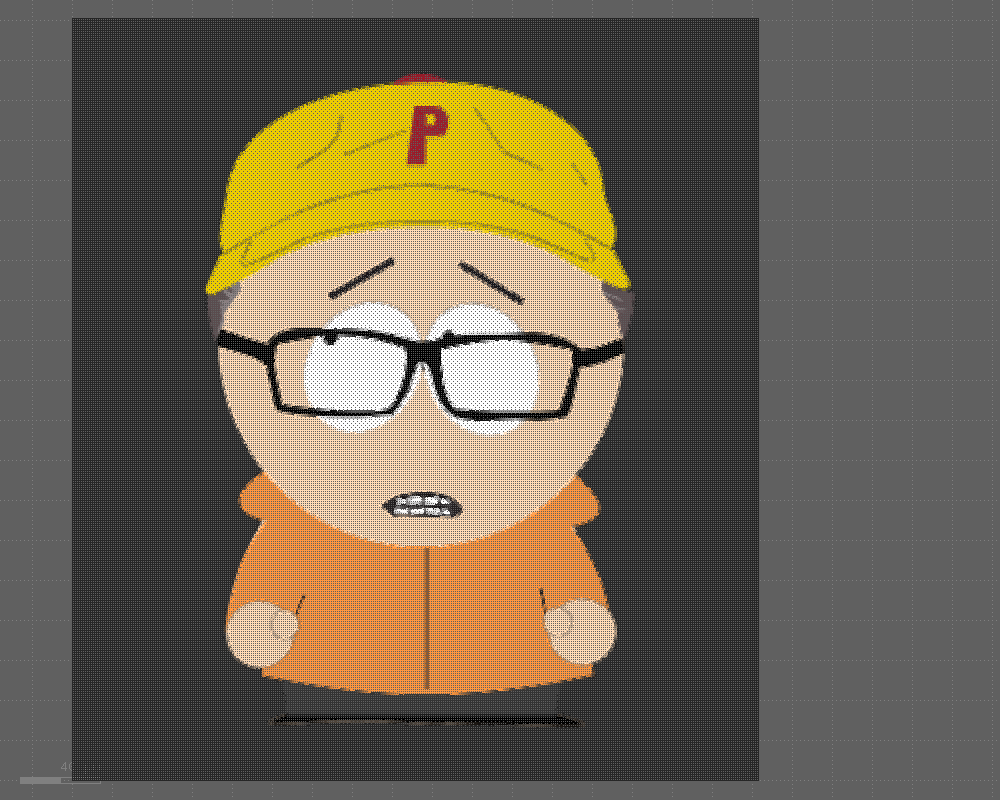

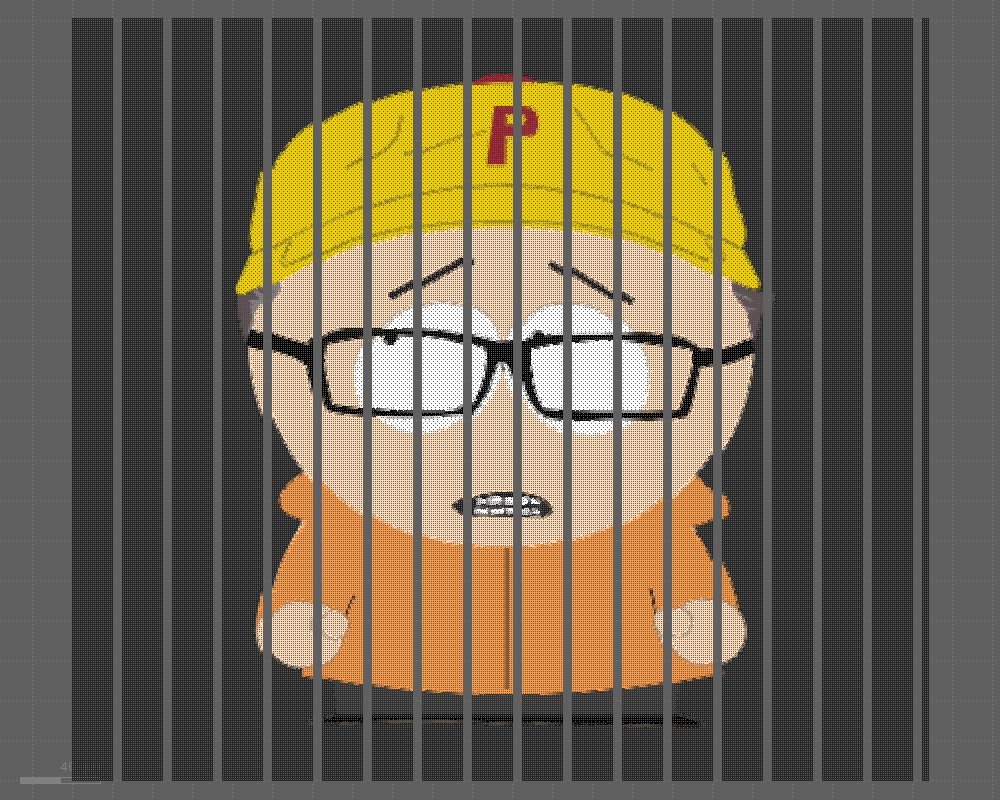

  • Do these images look like what you want?
  • Yes!! Exactly!
  • OK. Then, the attached solution of mine will help.
    But you need to modify the lines shown below to reflect your environment.
    Good luck!
    Kazzz-S

    Step-by-step operations (Images captured on macOS)
    Saving the layout
    This script does not generate any output file in GDS2 or other formats.
    You can manually do so.
    Or you can add some more code to save the layout automatically. ===> Reference
    Kazzz-S

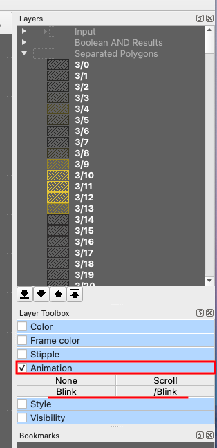

  • Hi everyone,
    I was away for a bit, so have started back at this. Just a quick question though. How do i switch of the function for blink?
    Probably something very silly no doubt!
  • edited November 2022
    Select a layer, or multiple layers, then follow Layer Toolbox ---> Animation ---> Blink or /Blink (inverse timing). None to turn off.
    Kazzz-S
