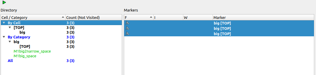

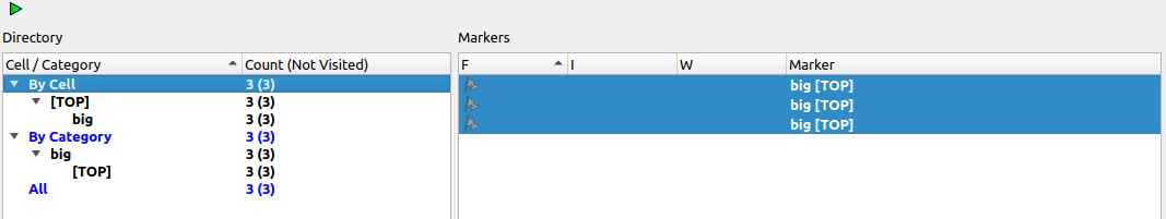

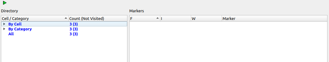

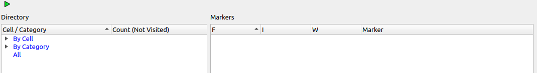

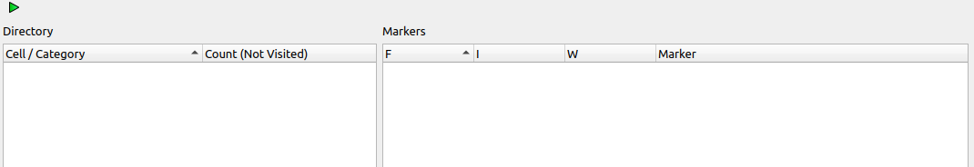

Hi Jim,
here is the difference:
1. Without errors:
Collapsed:
Expanded:
Without "Show all" (right-click on categories list):
So if you want to get a quick feedback, uncheck "Show all" and if the window is empty, there are no errors
