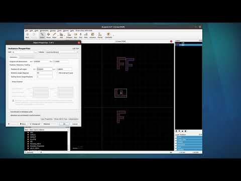

@aprxl The properties dialog now acts instantly when you change a value, so there is no "Apply" anymore. Using "Change all" will apply the changes immediately to all selected objects once you have enabled this feature.
Here is a video showing the "Change all" feature for instances:
Ah ha, I was clicking change all after rather than before. Thank you @Matthias
